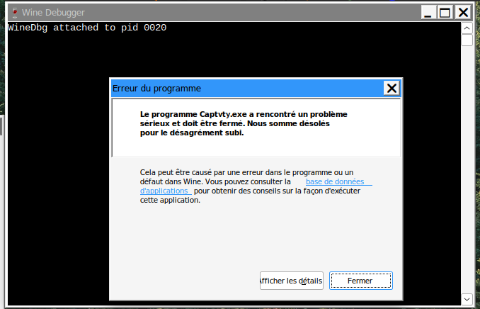

Une nouvelle version de Wine vient de m'être proposée. Je constate deux anomalies :
1) pour v2 comme pour v3, le panneau "mise à jour en cours" n'est pas affiché
Le panneau "Voulez-vous afficher ..." est cependant toujours présent 2 fois pour la v3
2) La v3 plante au lancement
Capture d’écran du 2025-10-18 18-17-31.png (35.55 Kio) Consulté 6582 fois
Unhandled exception: 0xe0434352 in wow64 32-bit code (0x7b5fb727).

PE-Wine 7bb40000-7bcb7000       Deferred        kernel32
PE-Wine 7bcd0000-7bfe6000       Dwarf-4         ntdll
ELF     f5ce9000-f5d78000       Deferred        libgmp.so.10
ELF     f5d78000-f5dc2000       Deferred        libhogweed.so.6
ELF     f5dc2000-f5e0c000       Deferred        libnettle.so.8
ELF     f5e0c000-f5e24000       Deferred        libtasn1.so.6
ELF     f5e24000-f5fcf000       Deferred        libunistring.so.2
ELF     f5fcf000-f5ff2000       Deferred        libidn2.so.0
ELF     f5ff2000-f614f000       Deferred        libp11-kit.so.0
ELF     f614f000-f637e000       Deferred        libgnutls.so.30
ELF     f638e000-f6395000       Deferred        ws2_32.so
ELF     f6395000-f639c000       Deferred        crypt32.so
ELF     f7393000-f73a1000       Deferred        libxrender.so.1
ELF     f73a1000-f73af000       Deferred        libmd.so.0
ELF     f73af000-f73c7000       Deferred        libbsd.so.0
ELF     f73c7000-f73cf000       Deferred        libxdmcp.so.6
ELF     f73cf000-f73fd000       Deferred        libxcb.so.1
ELF     f73fd000-f754f000       Deferred        libx11.so.6
ELF     f754f000-f7566000       Deferred        libxext.so.6
ELF     f756a000-f7576000       Deferred        libffi.so.8
ELF     f7576000-f7584000       Deferred        bcrypt.so
ELF     f7584000-f7600000       Deferred        winex11.so
ELF     f7705000-f770b000       Deferred        libxau.so.6
ELF     f77a1000-f77d2000       Deferred        libexpat.so.1
ELF     f77d2000-f7822000       Deferred        libfontconfig.so.1
ELF     f7822000-f7845000       Deferred        libbrotlicommon.so.1
ELF     f7845000-f7863000       Deferred        libz.so.1
ELF     f7863000-f78a3000       Deferred        libpng16.so.16
ELF     f78a3000-f7970000       Deferred        libfreetype.so.6
ELF     f7970000-f7a78000       Deferred        libm.so.6
ELF     f7a96000-f7c80000       Deferred        win32u.so
ELF     f7c80000-f7d43000       Export          ntdll.so
ELF     f7d43000-f7f78000       Deferred        libc.so.6
ELF     f7f7c000-f7f86000       Deferred        libuuid.so.1
ELF     f7f86000-f7f94000       Deferred        libbrotlidec.so.1
ELF     f7f98000-f7fd0000       Deferred        ld-linux.so.2
ELF     f7fd0000-f7fd5000       Deferred        <wine-loader>
Threads:
process  tid      prio    name (all IDs are in hex)
00000020 (D) Z:\home\pulsar33\.captvt3\Captvty.exe
	00000024    0 <==
	00000150    0
	00000154    2
	00000158    0
	0000015c    0
	00000170    0
00000038 services.exe
	0000003c    0
	00000040    0     wine_rpcrt4_server
	0000004c    0     wine_rpcrt4_io
	00000070    0     wine_rpcrt4_io
	00000084    0     wine_rpcrt4_io
	000000a8    0     wine_rpcrt4_io
	000000b4    0     wine_rpcrt4_io
	000000e0    0     wine_threadpool_timerqueue
	000000e4    0
	000000fc    0     wine_rpcrt4_io
	00000108    0     wine_rpcrt4_io
	0000010c    0     wine_threadpool_worker
00000044 winedevice.exe
	00000048    0
	00000054    0
	00000058    0     wine_sechost_service
	0000005c    0
	00000060    0
	00000064    0
	0000009c    0     wine_nsi_notification
00000068 svchost.exe
	0000006c    0
	00000074    0
	00000078    0     wine_sechost_service
0000007c plugplay.exe
	00000080    0
	00000088    0
	0000008c    0     wine_sechost_service
	00000090    0     wine_rpcrt4_server
	000000c8    0     wine_rpcrt4_io
00000094 explorer.exe
	00000098    0
	000000f0    0
	000000f4    0     wine_explorer_display_settings_restorer
	000000f8    0     wine_rpcrt4_server
000000a0 winedevice.exe
	000000a4    0
	000000ac    0
	000000b0    0     wine_sechost_service
	000000b8    0
	000000bc    0
	000000c0    0
	000000c4    0
	000000d0    0
	000000d8    0
00000100 rpcss.exe
	00000104    0
	00000110    0
	00000114    0     wine_sechost_service
	00000118    0     wine_rpcrt4_server
	0000011c    0     wine_rpcrt4_server
	00000120    0     wine_rpcrt4_io
00000168 conhost.exe
	0000016c    0
System information:
    Wine build: wine-10.17
    Platform: x86_64 (guest: i386)
    Version: Windows 10
    Host system: Linux
    Host version: 5.15.0-160-generic
Linux 64 bits / France / Google Chrome 141.0.0.
Publié : sam. 18 oct. 2025 17:52
par k3c
Je regarde, et je vais éventuellement mettre une note sur les forums wine
Android / France / Google Chrome Mobile 141.0.0.
